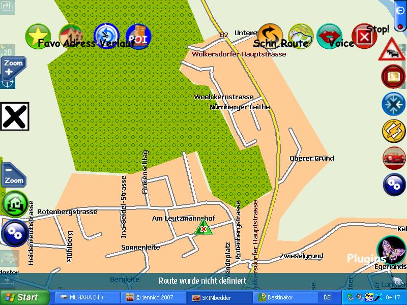

 !!!  I was using freedrive for almost a year on my carpc, but i'm using Destiplus since a couple of weeks with new maps, the biggest problem with freedrive.

| 1. navigate is always the green button, in the adress osk it's the tab key (sorry, it is labeled in german). doesn't it work ? |
| jennico hat folgendes geschrieben: |
| 2. you can change the zoom mode by clicking the zoom+ and zoom- button within half a second (not at the same time). this needs some practice, but it works. no possibility to toggle nav/plan mode yet. is this important ? then i will make it possible. but you are the first asking for that. |
| 3. i am planning tmc within destiplus but i need a lot more time for that. destinator pn is tmc capable and i am still looking for the right byte to switch it on. must be somewhere in destcore.dll. in the mean time i recommend showgps, a very fancy tool. |
| 4. at first sight it seems that i cannot change the cursor cross. but maybe i find it out some day. i will keep it in mind. but i think using a touchscreen the cursor doesn't matter at all. edit: i found out the cursor thing. you can change it in the windows system settings. select mouse and then pointers. exchange the cross (precision pointer) with another one. i like the green dinosaur. |
